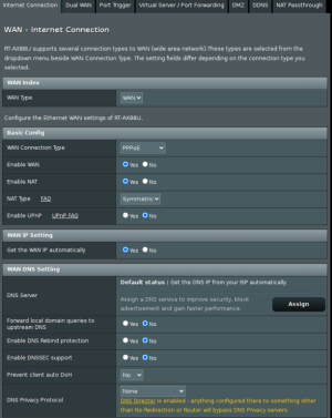

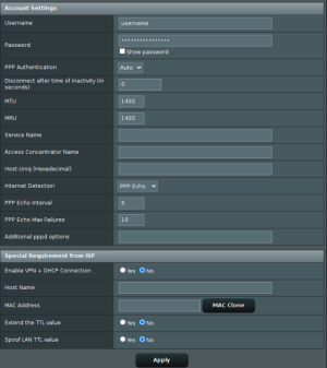

Please take a look. Hope it helps. Is from 1Gb, PPPoE, without IPv6 on a RT-AX88U powered by Asus Merlin Firmware: 3004.388.5.

Also on Community Fibre, cloned the supplied Linksys router MAC , connection type is automatic IP, I do have IPv6, DHCP-PD. To get it running the first time I connected the Linksys router to the ONT, checked it was working using Wi-Fi on my phone, cloned the MAC on RT-AX88U and applied settings, unplugged the cable from the WAN interface of the Linksys and plugged it into the Asus - connected straight away, though it took a few days for the connection to settle - currently running around 410Mb down/ 560Mb up - speed is limited as I am running WireGuard, so Flow Cache is disabled.
Thanks for all your help. Got it running. I called customer service and they cleared the Mac cache for their router and re provisioned the port. Didn't work at first, but I changed from PPPoE to AutoIP and worked straight away. I haven't enabled ipv6 and I'm getting 930mbps up and down.

From the screenshots I posted only username and password was supplied. The rest are set at the router default in my case.
