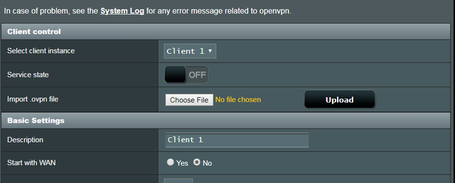

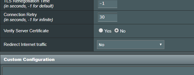

After initial flash, and WAN configuration, the VPN Client form looks good.
I can choose the client instance, and choose to use or not traffic redirect <= this is important statement.

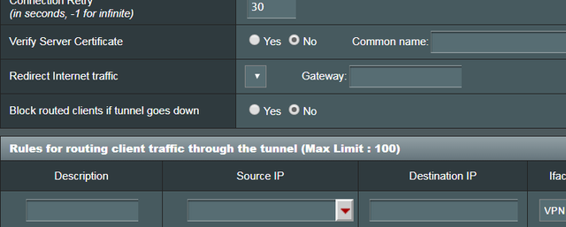

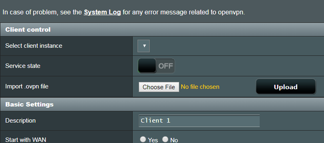

When I change the LAN to fix the subnet conflict, to 192.168.2.1, the VPN Client form becomes broken:
"Select client instance" is empty, and so is "Redirect internet traffic".
So I cannot exclude IPs from VPN, and I cannot setup more than one VPN instance.

Better explained with images:
1/ Before LAN modification:
2/ After LAN modification
