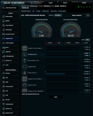

Sorry, I could not access my router to update. Here is what I changed and you can see my QoS is off
Which device is your modem? The first one on top?
The first one that is red, which is set to highest priority. Second one is gaming device, set at medium, but I have another one set at high (not turned on at the moment).
Your cable connections are wrong. The reason you couldn't access the router's GUI and the indicators on top show WAN disconnected with warning notification perhaps for your DDNS service. Your router right now is a wrong configured switch + access point on the ISP device network.

How certain are you the red device is your modem? I never see my modem visible anywhere on my router. What I see on the other end of my WAN connection is the ISP’s next hop device (not in my home).
From the information provided so far - most likely the ISP modem/router is connected to a LAN port.
My mistake, I thought I had verified the mac address, but it was not my modem. I also that it was weird that it would show up in that list. So although placebo makes sense, it did improve latency stability.

It's correctly connected to the WAN port, and modem is in passthrough mode. My mistake was in not verifying the mac address properly.
Your GUI screenshot above shows no WAN connection and a warning notification. Check what's going on there first. Your main GUI page shows WAN information. With ISP device in passthrough or bridge mode you must have public or CGNAT WAN IP address from your ISP.
Would be nice if setting priority on devices auto enabled QoS
Asuswrt is known for lack of dependencies. You may have completely contradicting settings and they will be accepted.
Yeah, it shows correctly on the main GUI page. That broken image is incorrect, I have a public wan ip address from my isp. I have also recently factory reset and don't have any additional modules or customizations made. I did just update to 3004.388.8_2 and the picture shows connected like it should now.
