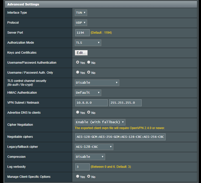

I need to be able to connect from my iphone away from home, to the my home network to access the internet as well as network devices such as a NAS etc.
I have successfully managed to get the Open VPN server working on Asus RT-AC68U running merlin 384.8_2 to the point where my iphone (not connected on wifi) can connect to the VPN server and can access the internet through the VPN.
However, as well as routing internet through the VPN I also would like devices on my home LAN to be available to the iphone when connected through the VPN.
At the moment, this is not working, i.e. I can not access 192.168.1.5 from my iphone when connected through VPN.
The router IP is 192.168.1.1
I have tried and failed every single different fix method I have found on google.
This includes custom script, routing table.
Nothing I try will allow me to connect to 192.168.1.5
The iphone is given an IP of 10.8.0.2 by the VPN server and the device is on 192.168.1.5, so I know this a routing issue, but I can't see to find a setting to fix this.
Can anyone suggest an idea for me to try get this working?
here is the current set up:
Thanks in advance
I don’t run a VPN, but I would check that the device at 192.168.1.5 does not have its own firewall that is blocking 10.8.0.0 addresses.
I am pretty sure it is not, but I think the solution is I need the LAN devices to think that they are being accessed from the same subnet, but I just don't know how to do this.
For info I tried the guide by Yorgi here: https://www.snbforums.com/threads/h...with-asus-routers-380-68-updated-08-24.33638/
But I do not have the Push LAN to clients option on my set up - not entirely sure if this is the problem
The Push LAN to clients and some other options were removed in recent firmware update. I have seen this question before. I think the main complaint was not being able to connect to a NAS though. I believe the issues is because you are on a different subnet when connected to your LAN over the VPN tunnel.
ON OpenVPN server it's possible to "push" routes to connecting clients. So in the server config something like push "route 192.168.1.1 255.255.255.255". More details here.
https://openvpn.net/community-resources/how-to/#scope
Please let us know if it works.
