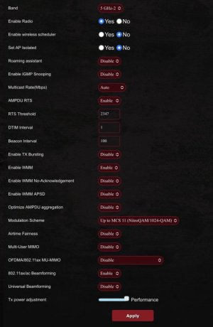

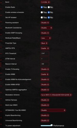

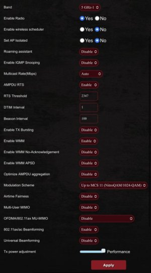

Devices: 2 iPhones, 1 Smart TV, 1 Fire Stick, 1 2.4ghz Security Camera, 1 PS5, 1 Computer.
Router: ax11000 Pro.
My connection has always been pretty smooth/fast and seeming perfect to my feel.
Recently I’ve added the 2.4ghz security camera and smart TV waiting on my other one to be delivered to replace the fire stick so 2 smart TVs, I was wondering if there are any settings I’ve needed to enable/disable to fix the freezes/lag spikes while watching TV and even when I’m playing on my console to the point it’s not enjoyable anymore, never had these issues before until I’ve added the new devices.
Any help would be appreciated.
Depending upon where you reside, the best router settings for the average consumer are the defaults. With Asus that includes the Dual Band SmartConnect. Yes, you can change the advanced settings but doing so can get you into more trouble. If you are experiencing buffering it may be your internet connection and not the router WIFI settings.
What firmware and version are you using?
Are you cable or FIOS and what bandwidth do you pay for? What are your actual bandwidth speeds?
What are your DNS settings?
Edit: If you are forcing 160 MHz, change that to 20-40-80-160 MHz and disable DFS channels to see if that helps.
