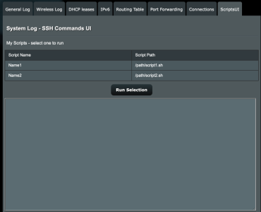

@jacklul, @dave14305, @thelonelycoder, @RMerlin would the following alternate approach still pose security concerns
- Custom user tab that has a hardcoded list of Names (prototype screen shot below)
- When clicking on one of the names, it somehow (I still don't know how to do that) runs a corresponding predefined script stored under /jffs someplace and the script doesn't accept any parameters
- The script runs and writes it's results to a file
- The custom user tab .asp reads the contents of the results file and displays it in a text box
If the above approach avoids the security concerns, can anyone point me to an example or reference on how to run a predefined script from .asp and wait until that shell script completes? I think I have the rest of the .asp code worked out, minus that one part.
