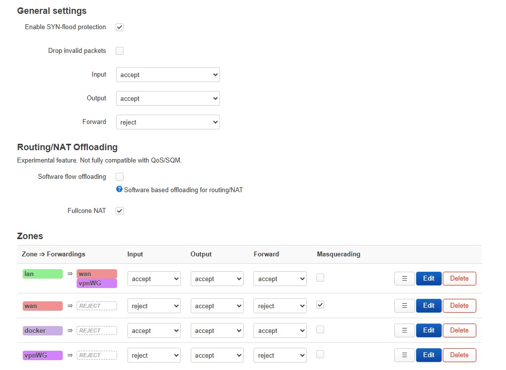

I have a WireGuard site-to-site VPN.
I would like that devices located in VPN-server side could access to devices located in VPN-client side, while device from VPN-client side connects to internet using the tunnel.
The part "VPN-client side connect to internet using the tunnel" is working fine.
the configuration is the following
SERVER SIDE
Router asus wrt merlin running wireguard server
Router ip 192.168.119.1
WireGuard server ip 10.6.0.1
Intranet option enabled
Allowed IPs(Server) 10.6.0.120/32,192.168.120.0/24
Allowed IPs (client) 0.0.0.0/0
Static route
Host 192.168.120.0
mask 255.255.255.0
gateway 10.6.0.1
interface LAN
CLIENT SIDE
Router with OPENWRT
Router ip 192.168.120.119
WireGuard client ip 10.6.0.120
Configuration pictures of client side follow
I wonder if I have to define a forwarding vpnWG=>lan
And I am also not that sure that Server side static route gateway should be something different
SERVER SIDE
Static route
Host 192.168.120.0
mask 255.255.255.0
gateway 10.6.0.1
interface LAN
CLIENT SIDE
Router with OPENWRT

Well missconfiguration could be also from asus wrt merlin side. I have an hybrid configuration .
Does your reply imply that my server side configuration is correct ?
