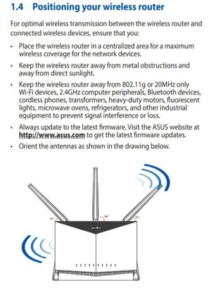

The English user manual for the RT-AX86U Pro indicates, on page 9, the following antenna positioning:

Interesting. The manual for this router says to position the antennas in a “W” pattern with the outer antennas at 45 degrees. Curious to know which instructions say to position them all vertically?
The user manual and default settings are about covering what works okay in most cases. Not the best and not optimized for specific user environment. This is a consumer product and users are not expected to know details about how Wi-Fi works.

While I do not mind being proved wrong, I do remember back in June 2023 when I got the AX86U Pro, as a replacement for a failed AX86U, that I checked the on line manual for the antenna position. The AX86U did recommend a \ | / or W antenna position but the AX86U Pro on line manual did recommend | | | or all vertical. Unfortunately, I can not prove the later as all the manuals for the AX86U Pro, which are newer than June 2023, show \ | / antenna position.
Regardless of the manual recommendation, as has been said in several prior antenna position posts by Merlin and other tech heads, the antenna position is dependent upon the environment. For me with a single floor house | | | works just fine. In fact the AX86U AiMesh node in my basement works well with | | |.
So, use whatever floats your boat. But remember, what works today may not work tomorrow!
