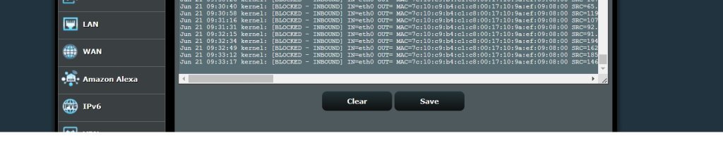

Installed skynet about a week ago and I keep seeing this blocked, what is it and should i be concerned ?
Jun 21 09:24:17 kernel: [BLOCKED - INBOUND] IN=eth0 OUT= MAC=7c:10:c9:b4:c1:c8:00:17:10:9a:ef:09:08:00 SRC=57.128.41.42 DST=99.242.**.2** LEN=40 TOS=0x00 PREC=0x00 TTL=45 ID=27448 DF PROTO=UDP SPT=64571 DPT=8000 LEN=20 MARK=0x8000000
Jun 21 09:24:31 kernel: [BLOCKED - INBOUND] IN=eth0 OUT= MAC=7c:10:c9:b4:c1:c8:00:17:10:9a:ef:09:08:00 SRC=162.142.125.232 DST=99.242.**.2** LEN=44 TOS=0x00 PREC=0x00 TTL=43 ID=16405 PROTO=TCP SPT=43644 DPT=8029 SEQ=3097837270 ACK=0 WINDOW=1024 RES=0x00 SYN URGP=0 OPT (020405B4) MARK=0x8000000
I took out someone of my ip address using **

This means that Skynet is doing what it is supposed to do; block IP addresses in the loaded blacklist. Here's mine:

Please be aware that, every time you are on the Internet, you IP address is constantly monitored by various players (friendly and, more dangerous, unfriendly peoples) and Skynet is there to help prevent many of them to be successfully achieving their goals:
If you install scripts like that you will get reports constantly , it is doing exactly what is intended.
Skynet has blocked a malicious IP address , one used for continuous port scanning.
>>> Abuse IPDB reports here <<<
With such a script you will see hundreds of entries a day.
I just installed it a few days ago, how come nothing bad happened years ago?
The "bad" stuff has always been there, every second of every day. You only see it if you read the firewall logs.
Set the ASUS firewall to log "dropped/blocked" packets and you'll see thousands of entries a day.

The problem is that too many people thinks that because they cannot visibly observe unusual activities that they are not subject to illegal intrusions and are operating in a secure environment.
Yup, and then they install scripts that they don't understand and panic when the script does its job.
