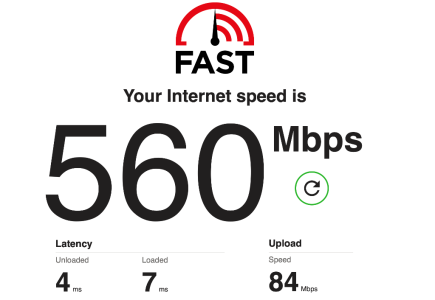

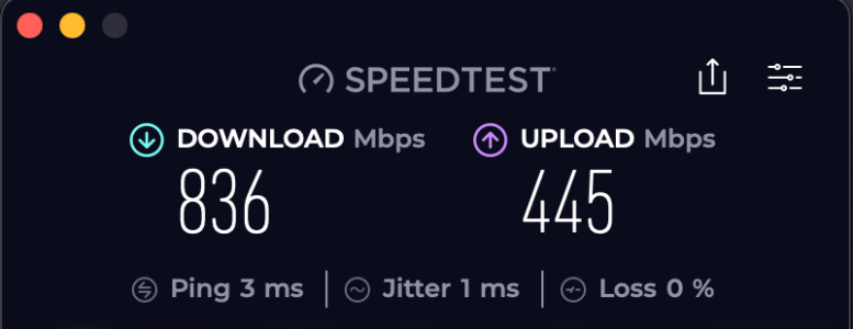

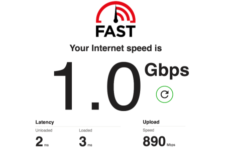

Also, fast.com seems to indicate a speed discrepancy that speedtest doesn't pick up. I've attached screenshots.
- Connected to the modem, I got 1Gb up and down
- Connected to the router LAN, I got about the same, but a bit lower on upload.
- Connected to WiFi, I got 560 down, which is not unusual in my environment, but the 86 up is VERY low. Especially being next to the router.
Again, speedtest gives me very different results on wifi. I've attached a screenshot of those results as well.
Overall, I'm honestly stumped. Would a factory reset accomplish anything?

Over many years I've never seen fast.com report speeds that were anything near reality. It's more like a random number generator for me.
