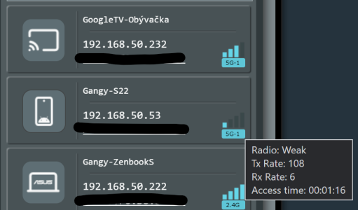

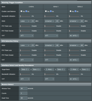

Please can someone help me understand what is going on here? I do not understand the purpose and mechanics of the configurations posted here at all.
I mean, if we measure the signal strength in dbm, dbm values are negative (-XXdbm), then I logically assume that If I want to set the rules on 5gHz band to kick all the clients with weak signal to 2.4GHz band, I should set both steering trigger and STA selection in the opposite way showcase here right? For example, if a clients RSSI is greater than like, -65, he should be kicked to 2.4GHz to have a better signal strength and more reliable connection, right? The settings showcased here use the numerical values in the opposite way, for example Deldariuses config says that if clients RSSI is less than -75, it should trigger steering. WHY?!!? Is not RSSI lower than -75 good signal strength and it should only trigger steering if the signal strength is weak, ergo RSSI greater than -75?
Id be very grateful if someone helps me to make sense out of this. In my household theres a lot of interference and the problem is that clients cling to 5GHz band even if their signal strength is weak which results in poor connections stability (high pings, occasional drops) when they should be kicked of 5GHz to 2.4GHz to maintan stable connection instead.
I have found all the written information on smart connect settings there is in english language and it seem literally noone knows how to set it correctly, as those values are all over the place when users showcase them, including the absurdities like the opposite value usage as I have explained earlier... I am completely lost.
Im including screenshot of my smart connect settings and the clients tab from my RT AX92U, as you can see there, my phone is still happily sitting at 5GHz with weak signal even tho it should be kicked off to 2.4GHz a long ago according to my rules, is this sh*t just bugged or am I doing something wrong?
//edit: yeah I know theres an attack vector to reveal MAC addresses from my screenshot right now, if youre willing to go through that work you can have em mate
A bit more info is needed to get a better picture of things.
1. What is the square footage of your domicile?
2. How many devices do you have? How many are Ethernet vs. wireless?
3. Is your router centrally located in the house? If it is not, see if it feasible to make is so. Proper router placement is quite important. An access point or extender may be needed to eliminate dead spots.
4. What are your Wifi settings? Proper channel settings come before smart connect.
Now let me look at your smart connect settings....
Oh my...
A case of less than / greater than.
Zero is the best dBM one could hope for. The closer you are to 0 the stronger the signal is. -29 is greater than -57 and -83 is less than -61.
For the Steering Trigger Condition the RSSI tells the router when to change the band.
In your case the 2.4Ghz will change bands when the RSSI is less then -55 (or weaker, -65 -> -75 -> -85...etc).
Then you have the 5Ghz initiate the change at -65 (or stronger, -55 -> -45 -> -35...etc).
You have overlap, nothing is going to move if the RSSI is between -55 to -65. The router is playing hot potato with itself.
Set the 2.4Ghz to Greater @ -65dBm
Set the 5Ghz-1 to Less @ -65dBm
Set the 5Ghz-2 to Less @ -65dBm
For the STA Selection Policy the Less/Greater are reverse of the trigger. This tells the router, that under the these conditions what band the device is to be moved to.
Set the 2.4Ghz to Less @ -65dBm
Set the 5Ghz-1 to Greater @ -65dBm
Set the 5Ghz-2 to Greater @ -65dBm
As far as the VHT for the 5Ghz-2 being set for AC only, that should be fine. I do not have a tri-band router, so YMMV.
The dBM's will need some tweaking dependent upon your specific environment.
Your Bounce Detect settings look a bit tight, those can get massaged after the RSSI is taken care of.

Thanks a lot, I have set smart connect according to your description, well see how it does in the next few days.
Yeah, thats on purpose as its a 2-story home and people like to go up and down the stairs a lot, while on the upper story the 5GHz signal is pretty spotty but 2.4GHz is fine plus there are some sudden interference bursts coming from god knows where (40+ SSID´s around me), I figured I set it this aggressively to ensure clients are on the best band most of the time.
Let me test your recommended config for some time and get back with my findings. Thanks a lot for now.

I did the exact opposite of this by flipping the greater than in Steering Trigger Condition for RSSI from Greater to Less and STA Selection Policy for RSSI from Less to Greater and it worked perfectly fine to switch me to 5Ghz_2 for Wifi 6 with my threshold being set at -75dBm instead of -65dBm as specified in the post above.
However, according to the article linked: https://www.digitalcitizen.life/asus-smart-connect/
"The STA Selection Policy settings are used to select the clients that are going to be steered to another band when the Steering Trigger Conditions set earlier are met. The STA Selection Policy settings are somewhat redundant and should be set to the same values as the Steering Trigger Conditions."
Therefore, I've reconfigured my router and now the STA Selection Policy mirrors the Steering Trigger Condition:
Still working just fine! Still testing though because not all clients who met the steering criteria is on Wifi6 and it's kind of bothering me... More to follow.
[Update]
Found a SNB manual on this very topic: https://www.smallnetbuilder.com/wir...s-rt-ac3200-smart-connect-the-missing-manual/
Going to take a look and configure accordingly. More STAs should be steered towards the 5Ghz_2 Wifi6 band on my AX92U but they are not... Weird!
