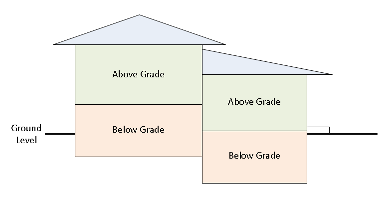

I am looking to upgrade my home router now that I have faster service from my ISP (150 down) and my home is a challenge to cover properly given that it is a 4 level split design similar to this.
In the past I've had an Apple 5th Gen Extreme (n) router located in the kitchen on top of the cupboards that provided passable coverage but it lacks AC speeds and in the bedrooms and basement it wasn't very quick. Most of the house has ethernet running to it so my AV gear and servers are all hardwired so they're not the issue its our laptops and mobile devices that I'm looking to improve on.
