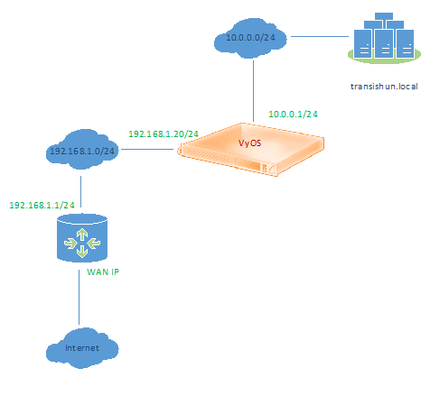

I've been desperately trying to set up my home network in a DMZ-Lab type configuration. Here's my current configuration:
Edge (Home) Router: Asus RT-AC87U running DD-WRT v3 buld 29193
Internal Router: VyOS 1.1.6 running on Hyper V
Here's what I'm trying to accomplish (yes, I stole these, but I've configured them exactly as outlined. If you'd like more background on what I'm attempting to accomplish, see this.)
I've also configured the VyOS router as follows:

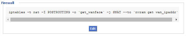

Hosts on the DMZ subnet can browse the Internet with no problem. However, my "internal" hosts cannot. With DD-WRT, this can be solved by entering the following in the Firewall section of the router:
And....it works! But only until DD-WRT crashes repeatedly which was why I moved on from it months ago. I flashed again with DD-WRT last night solely for the iptables command above. But it's just not worth it due to DD-WRT's instability, particularly on my model of router.
So my question is, can this be done with AsusWRT-Merlin? If so, how? I'd gladly switch back if this is possible, as the ASUS/Merlin firmware has been very stable and feature-rich.

How far did you get with this? I'm trying to setup a secondary network segment for a lab I'm building and ran into a snag... My setup is similar to yours with VyOS. In my case I'm trying to do a simple routed network (I have a static route on my main lan to my lab network, the lab network has a default gateway of the main lan router) but I'm having a routing issue between the servers on the different ip segments.
You might need to go back to Hyper-V, and build the virtual interface for the Vy-OS interface, once done, you can put it, and the children attached into the DMZ of the primary router/AP interface...
Keep the scopes separate...
