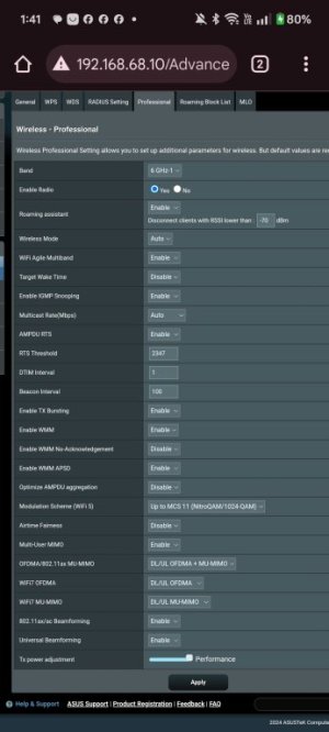

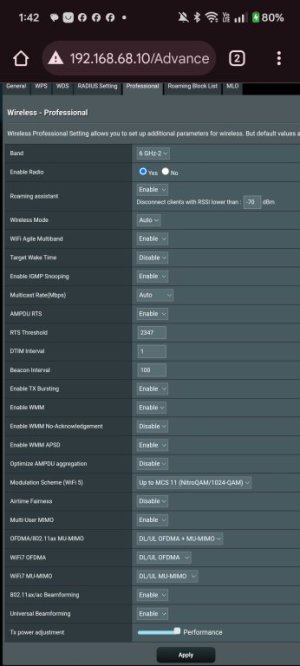

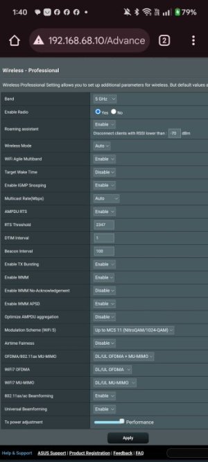

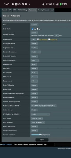

Mine setup is wired backhaul, but for your reference in case you would like to try...

I turned off roaming assist over the weekend and thought I had been in a more stable place, but I just lost network access (while my macbook showed connected to the wifi network still) in the middle of a zoom meeting - meaning TCP and UDP both lost connection.
Logs showed this (my laptop is the macid ending in be:38
Oct 21 10:21:11 wlceventd: wlceventd_proc_event(695): wl0.1: ReAssoc A6:DB:80:59:6F:D1, status: Successful (0), rssi:-91
Oct 21 10:21:11 wlceventd: wlceventd_proc_event(685): wl3.1: Auth B0:68:E6:09:92:90, status: Successful (0), rssi:0
Oct 21 10:21:11 kernel: SBF: dhd3: INIT [b0:68:e6:09:92:90] ID 65535 BFW 65535 THRSH 2048
Oct 21 10:21:11 wlceventd: wlceventd_proc_event(695): wl3.1: ReAssoc B0:68:E6:09:92:90, status: Successful (0), rssi:-69
Oct 21 10:21:13 kernel: SBF: dhd0: INIT [8e:af:82:f8:9c:8e] ID 65535 BFW 65535 THRSH 2048
Oct 21 10:21:13 wlceventd: wlceventd_proc_event(695): wl0.1: ReAssoc 8E:AF:82:F8:9C:8E, status: Successful (0), rssi:-82
Oct 21 10:21:24 NBR: [nbr data] nbr data of 10:7C:61:6D:F6:30 is updated
Oct 21 10:21:24 NBR: [nbr list] nbr list is updated.
Oct 21 10:21:24 rc_service: cfg_server 17578:notify_rc update_nbr
Oct 21 10:21:30 wlceventd: wlceventd_proc_event(645): wl0.2: Deauth_ind 4E:63:05:E8:BE:38, status: 0, reason: Station requesting (re)association is not authenticated with responding station (9), rssi:-84
Oct 21 10:21:30 kernel: WLC_SCB_DEAUTHORIZE error (-30)
Oct 21 10:21:30 wlceventd: wlceventd_proc_event(662): wl0.2: Disassoc 4E:63:05:E8:BE:38, status: 0, reason: Disassociated because sending station is leaving (or has left) BSS (8), rssi:-84
Oct 21 10:21:31 wlceventd: wlceventd_proc_event(645): wl0.1: Deauth_ind C4:35:D9:AC:4E:B6, status: 0, reason: Station requesting (re)association is not authenticated with responding station (9), rssi:-89
Oct 21 10:21:31 wlceventd: wlceventd_proc_event(662): wl0.1: Disassoc C4:35:D9:AC:4E:B6, status: 0, reason: Disassociated because sending station is leaving (or has left) BSS (8), rssi:-89
Oct 21 10:21:31 kernel: WLC_SCB_DEAUTHORIZE error (-30)
Oct 21 10:21:33 wlceventd: wlceventd_proc_event(685): wl3.1: Auth D8:A0:11:49:0D:D8, status: Successful (0), rssi:0
Oct 21 10:21:33 kernel: SBF: dhd3: INIT [d8:a0:11:49:0d:d8] ID 65535 BFW 65535 THRSH 2048
Oct 21 10:21:33 wlceventd: wlceventd_proc_event(722): wl3.1: Assoc D8:A0:11:49:0D:D8, status: Successful (0), rssi:-51
Oct 21 10:21:37 smarthaul: : cycle 101017: mbh 0 linkset red to 5, new tidmap fff0ff(L0L1L2)
Oct 21 10:21:39 wlceventd: wlceventd_proc_event(685): wl3.1: Auth 64:C6:D2:98:34:1A, status: Successful (0), rssi:0

Have you tried setting up the nodes as access points? I was experiencing random WiFi disconnections when connected to the nodes, after the switch WiFi is 100% stable.
Skypx… how do i do that? I have 2 BQ16’s (uk) one is ethernet backhauled via..i assume ai mesh …across 1 ssid for wifi. Is there step guide somewhere on best approach…not seen one.
If your nodes are wired to the main router/BQ16 then Ethernet Backhaul Mode seems to help. AP mode is only available for wired nodes. OP is wireless backhaul, maybe Repeater mode...
The OFDMA/MU-MIMO and Beam forming settings look like they need manual configuration now that ASUS removed the WiFi 7 toggle...
Lol …u lost me at if your nodes are wired ….. :) while i’m not that bad faffing in detail is why i use aimesh …asus!!! Sort out the BQ and please drop a fixed firmware.
