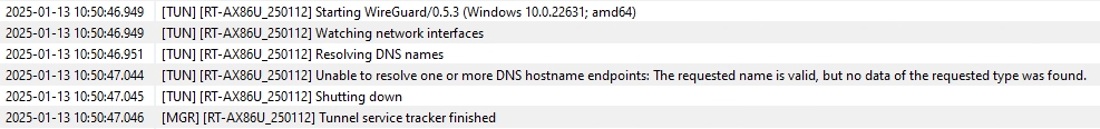

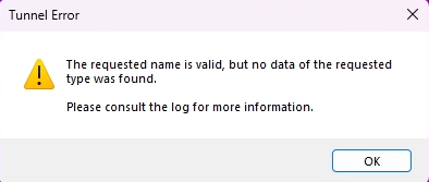

However, on my Windows laptop, I cannot get WireGuard to connect. WireGuard client on laptop just throws an error "The requested name is valid, but no data of the requested type was found".

Here's a screenshot of log.

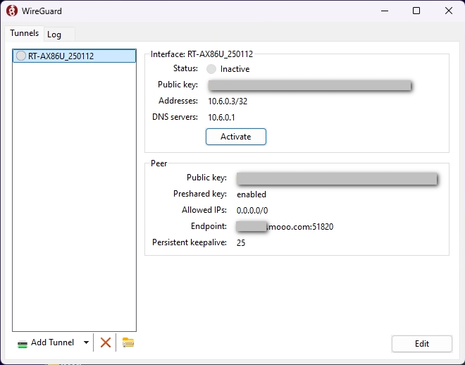

And here's Tunnel page.

I guess you probably already have but check the imported endpoint in Windows so everything appears right.
