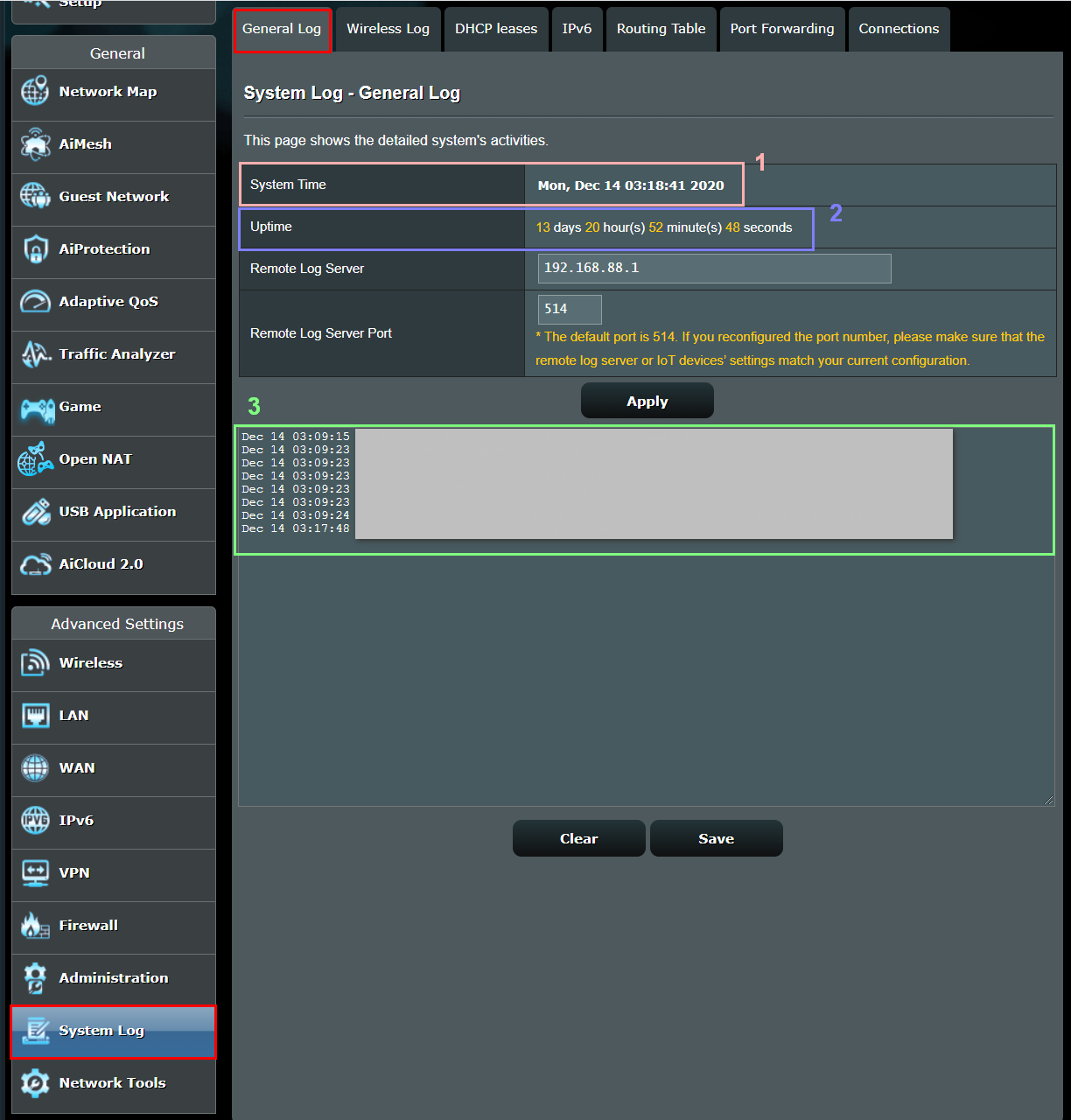

Are you using a hostname or IP address to connect? Are there any logs on the router end during the connection attempt?

well your wireshark revealed what happened. But if your router has an SSH log, I would turn it on if its not on and look at why its refusing the connection. Because there are not many things that can prevent it from connecting and a port redirect is the commonly programmed weak sauce defense against a DDOS attack on a router. If the laptop is able to SSH into anything else (other than itself), then the laptop has no issues. Make sure the user/password is correct.
