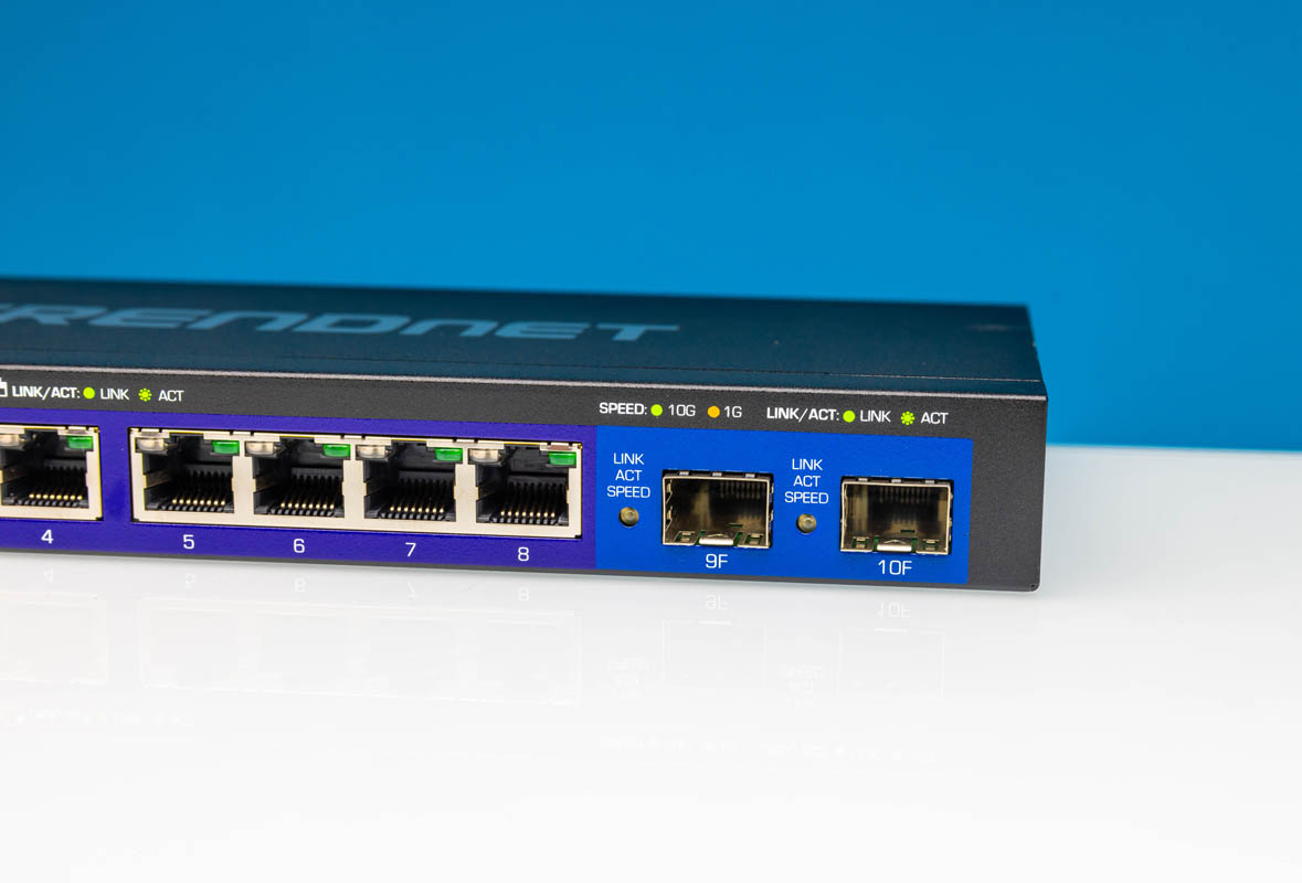

TRENDnet TEG-3102WS
8 x 2.5​
2 x SFP+​
Min. power consumption (watts)​
5.6​
Max. power consumption (watts)​
22.2​

Closest is the trendnet which people complain overheats especially if you use SFP. TPlink is either lying about the 15W or they managed to build the first fanless, managed 2.5Gb switch that doesn't suck.
