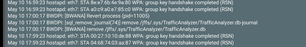

Well, I just finished testing this just to see if moving the TrafficAnalyzer db file to my flashdrive would cese the spurious database deletions, which would have indicated some problem with my router's /jffs/ nvram partition. However, also in this case the TrafficAnalyzer decides to erase the database without reason, so I definetly think now that this is some kind of bug in recent versions of the GPL on which Merlin is based (experienced this with 388_9 and 388_9_2) .
Remember that to verify this bug you must see in the logs similar lines to :
May 10 11:00:21 BWDPI: [BWANA] Revert process (pid=31415)
May 10 11:00:21 BWDPI: [sql_remove_journal(74)] remove /tmp/mnt/sdb1/TrafficAnalyzer.db-journal
May 10 11:00:21 BWDPI: [BWANA] remove /tmp/mnt/sdb1/TrafficAnalyzer.db

In my case I have observed in the log file that the db erase thing happens always at timestamps that are at an exact hour plus 20 seconds. i.e the last 3 occurences happened yesterday at 11:00h:20 sec, and today at 18:00h 20 sec and 23:00h 20 sec. This makes me think that the problem happens in the process that refreshes the traffic count, which happens hourly.
Every hour, the hour_monitor process runs these 2 commands:
TrafficAnalyzer -e
TrafficAnalyzer -d 14336
The first one saves the stats, the second one prunes the DB file.
You can activate a certain amount of debugging with this command:
touch /tmp/BWSQL_LOG /tmp/BWMON_LOG
Then, the bwdpi processes will write extra output to:
/tmp/BWSQL.log
/tmp/BWMON.log
If you experience the problem, maybe these logs will reveal additional clues as to what is happening before “Revert” and delete.
Stop the logging with:
rm /tmp/BWSQL_LOG /tmp/BWMON_LOG
The SQL log will likely grow faster than the MON file, so watch the free space in /tmp after a few hours.
