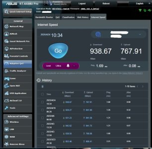

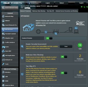

I have an rt-ax88u-pro and have no issues hitting 950+ on my 1Gig internet pipe with aiprotection enabled. As others have said you must have something else going on.
+1.

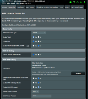

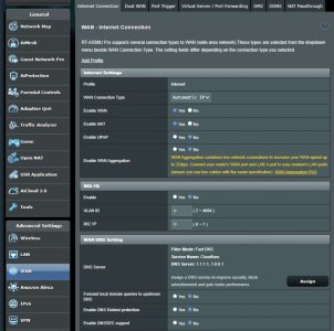

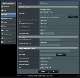

You're right, saying it 'works for me' is ultimately not that helpful save to say it is not a TM related issue for others. Taking a sideways step then and scratching my head, maybe some other things to try/check/ask you.
  • Do you think TM is affected by / locking up / throttling something due to the DNS settings; maybe flick your eye over my WAN settings, I use cloudflare btw.
  • The machine you're testing it from is directly connected to the Router, via Ethernet, has 1GB Ethernet Adapater itself, is not through an old 10/100 Switch (although the Ports would not all show green per daves question) if that were the case.

Thank you for you understanding and I get your point: my initial statement "TM bottlenecking Asus routerS" is obviously not correct thanks to examples from others.
  • To be honest, I'm not sure, I'm kinda learning some things on the fly right now. I'm on Quad9, but I'll think on your suggestion (have to get to work in a bit)
  • The desktop I'm testing from is directly connected to the router via cat5E, and the pc has a 2.5 native port. As a sidenote: I'm also using the speedtest in the WebUI of the router itself to compare (router is directly connected to the ISP modem via a cat6, tested with a brand new cable again yesterday), and the speedtest on the router reports the same situation
