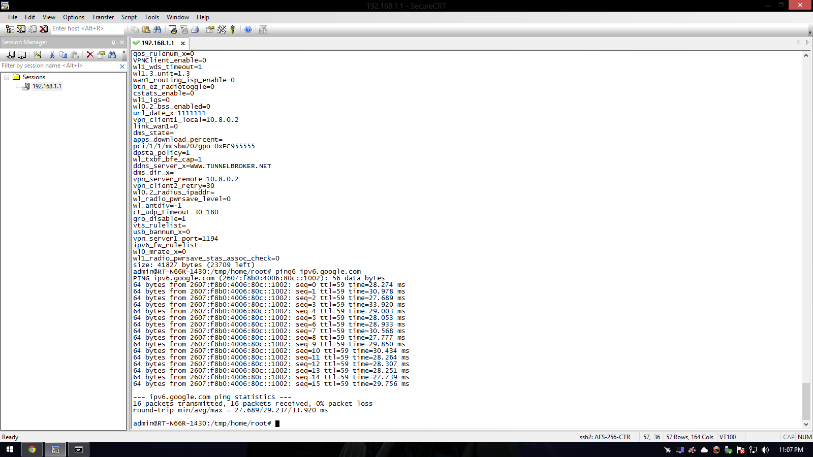

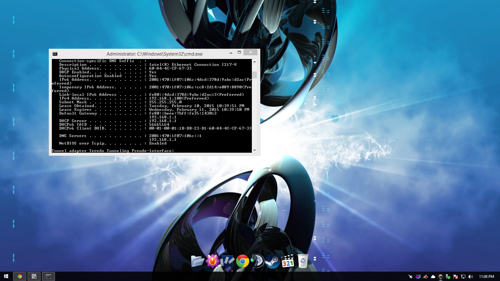

yea I setup ssh and I can ping6 ipv6.google.com but nothing from the client even tho windows says I have the correct ipv6 address and dns

As I said, I did my test from my Windows PC, not from my router.
If you can do it only from the router, then something on your PC is causing the issue. Either it's not properly listening to RA, or you have some firewall rules in place blocking the traffic.
ok I got it fixed it was ASUS's ROG GamerFirst II packet-shaping Utility(which is based on Cfos)
why I didn't think of that I don't know
everything is well now
