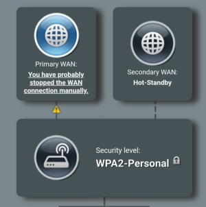

Ok, manually switching off primary wan won't switch to secondary wan
Manually unplug the cable then, don't be lazy. :)
