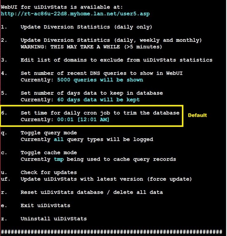

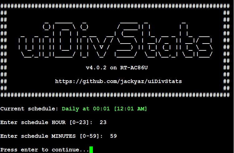

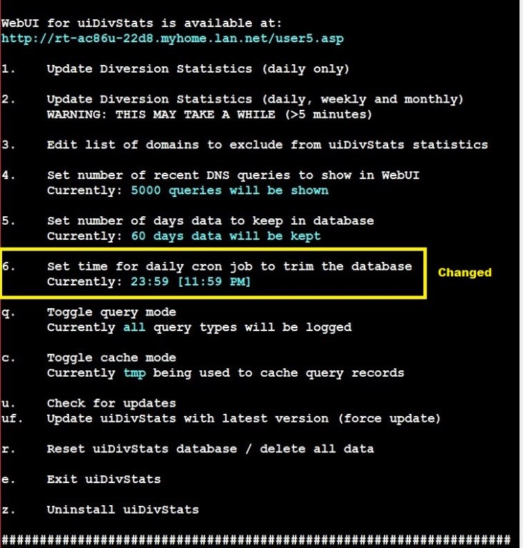

Release Notes for uiDivStats 4.0.2 version (now available):
1) Redirected version update requests from the 'develop' branch to the 'master' branch.
The 'develop' branch is *not* supported/available on the repository.​
2) Added a new menu option to allow users to set a preferred time for the daily cron job that trims the database.
3) Various code improvements & fine-tuning.
The new option 6) is available in the SSH CLI menu:
This allows users to set a preferred time when the trim database process would not affect internet activity (e.g. scheduled at 3:00 AM rather than the current default 12:01 AM).
