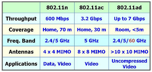

N = 70m
AC = 30m
AD = < 5m
Those paper specs seem definitely too much optimistic / unreal to me. :)
I go for:
N = 1 average home
AC = 1 room
AD = 1 meeting table
AC can definitely cover much more than a single room and still give you efficient throughput. My Nexus 9 can still get a 50% signal from the opposite end of my apartment.
Yes but thats not 30m for sure, not even 15...
My apartment is built length-wise. That's about 20m, including 3 walls.
An AC router should be fine covering a single apartment, especially if you install it in a good location (mine isn't optimal due to the way the whole apartment is built, and the Internet entering at the front).
