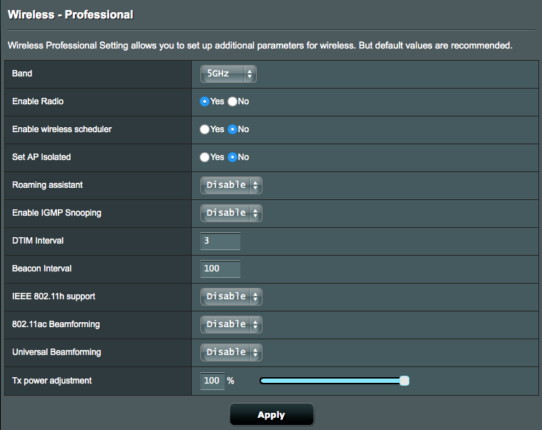

Try disabling beamforming. It has greatly improved stability for numerous users.
Part of the problem is also on Apple's end. After a few iOS updates, they still seem to be struggling with resolving the issue. Part of the problem is their overly aggressive power management, and also the fact they like to play weird games for some odd reasons (such as randomly changing MACs for some obscure reason).
Beamforming is already disabled.

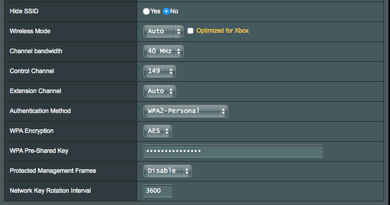

I'm using 40MHz because I don't have any AC devices and 80MHz gives me much slower performance.

Here is how I fixed the issues with my iOS devices connecting to 5 Ghz:
Network Key Rotation Interval : set to 0
Disable all Beamforming
Beacon Interval: set to 50.
After I had done all that, I haven't seen any issues at all. And the 5Ghz now is very stable both on Merlin's 378.53 and the asus's latest 3.0.0.4.378_5134

If my problems come back, I'll try dropping the beacon interval to 50. I'm not at all comfortable setting my key rotation to zero, due to the security implications there.

5GHz: Channel bandwidth 80MHz, Control Channel 48, Network Key Rotation Interval 0, DTIM Interval 1, Beacon Interval 79, , IEEE 802.11h support disabled (but when logging on via SSH and checking the actual value, I can see that it is enabled anyway), 802.11ac Beamforming: Disable, Universal Beamforming: Disable. The rest default.
