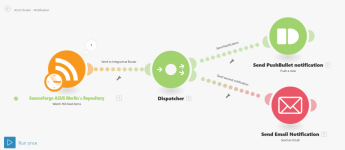

Hello.
One simple way to get notifications (need to read a little...) is to use free Integromat (since IFTT become less free.... ) with RSS feed from SourceForge.
So, my solution goes like that :
1. Check RSS feed for new items on a remote URL (copy folder RSS link and use it for remote URL , for example, for AC88U it is https://sourceforge.net/projects/asuswrt-merlin/rss?path=/RT-AC88U/Release )
2. Make a module in Integromat ( https://www.integromat.com ), and if new items, then add a router and do what you want (Telegram, What'sApp, PushBullet, Pusher, Email, SMS, you name it ! Integrator comes with more than 1000 integrations, you could even make a led blink on a little iot device, like esp8266 or arduino, powered from back usb. Hey ! that's a cool Idea ! )
Maybe the attached image speak more than me :) .
In the future, if have time, I will code a plugin for HomeAssistant (a homemade IoT gateway that run from a Raspberry PI) that could display a message on the board (personally I use an old tablet on a wall as dashboard). So much fun with such a pleasant community !
Like this, I will not stress router with scheduled tasks, not using his memory / cpu and so on.
Hope this helped you, as others posts helped me to come out with this solution. I was feeling in debt to give back to this wonderful community. Thanks you all.
