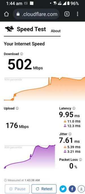

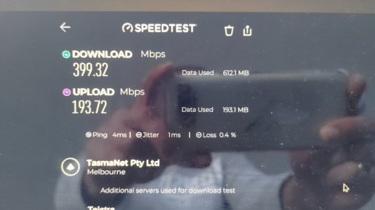

I am Dealing with exact same issue. only using WiFi onMobile though. using ROG Phone 5S.
My son's laptop sitting far away gets around 4ms where as I get around 8ms.
and that's using same server too.
Not surprising, your phone is nowhere near as powerful as the PC and has a microscopic wifi chipset and antenna in it.
I can't think of anything you'd be doing from your phone that would notice the difference between 4 and 8.
Honestly 4 seems almost impossibly low, wonder if the PC is caching something - does the laptop happen to have one of the Killer Wifi cards in it?

thanks for reply .
I use to get around 5ms ping consistent on same phone with my old RT AC68U.
the laptop However is only about a year Old its Dell Inspiron 13 7000. I am really not sure what sort of WiFi card its got. my son plays lot of Roblox and YouTube and also use it for studies.

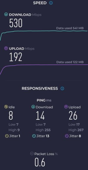

I did some tweaking like turning off roaming, universal Beamforming off and set 2.4GHz signal to 40MHz and 5GHz to 160MHz . also I setup Good Channels for both manually using WiFi analyser and speed is much consistent now and pretty much same as wired connection on my main PC.
I know I might be able to lower ping rate a notch down by turning off Ai Protection but Its not worth just to have 1ms lower ping.
ping stays between 6-8ms now unless I am on the other end of house.
thanks for help.
see speed below.
thanks for help.
see speed below.
https://www.speedtest.net/my-result/a/9346463374
Be nice to others in the area and change your 2.4 back to 20mhz. You may find that 5ghz 80mhz actually gives similar speed, more consistency, and better range than 160 too.
Most likely universal beamforming disabled made the biggest difference, it typically sacrifices signal strength for coverage range.
will do that. it's just that I saw some close by signals showing 40MHz. but for sure give it a try
