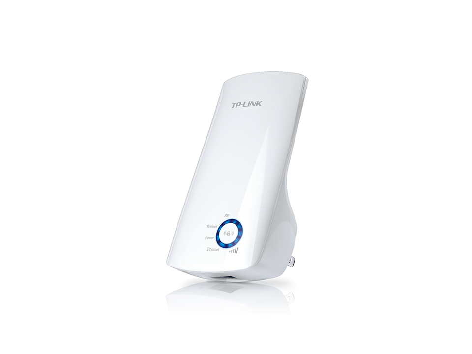

A friend of mine had constant issues with 2.4GHz Wi-Fi connected printer a bit further away from the AP. Very similar to @gogreen1 situation. I told him to stop by Staples or BestBuy and get one TL-WA850RE repeater for $15. The repeater was set to create a hidden SSID for printer use only. It was like 2 years ago, both owner/printer are happy since. Sometimes there is a cheap readily available solution.

Thanks, all, for the advice. I think my options are the upgrade to the Pro version of my router or try a wifi range extender, like the TL-WA850RE.

The difference is $220 vs $15 and the need to re-configure your router from scratch vs 2min extender setup. The choice is yours.
