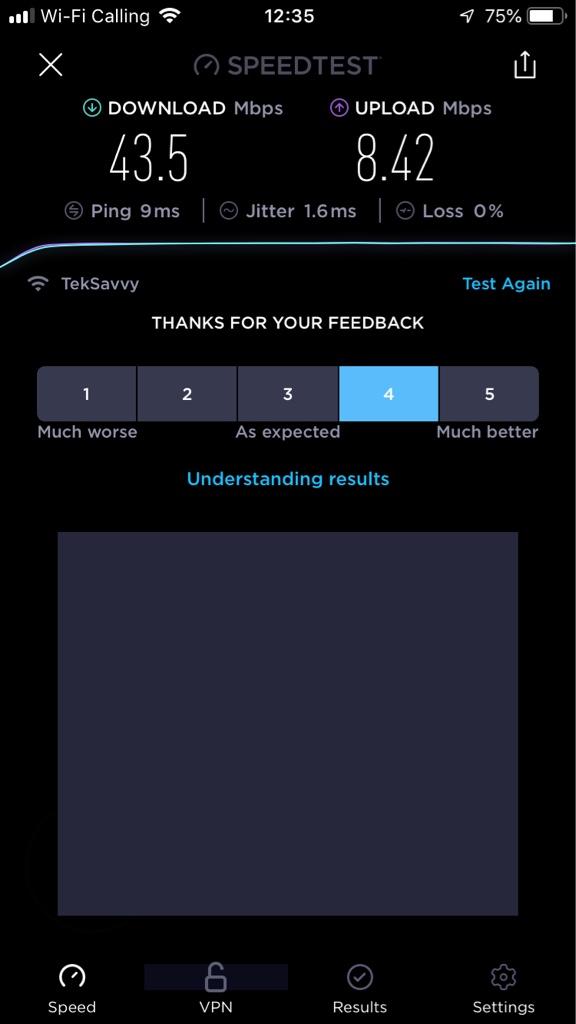

For DSL, I believe the rule of thumb is to expect 10% below advertised/promised speeds (yes, I know you said fibre, but to WHERE?). I pay for 50/10 and this is what I just tested to:
