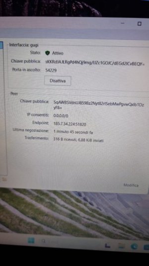

INTERFACE:
Private Key
xxxxxxxxxxGVEwAIve+huHKfKsTIOEoXxxxxxxxx=
MTU (Optional)
Address
10.6.0.2/32
DNS Server (Optional)
PEER
Server Public Key
SqAWBSVdnUJ859Bz2Nyt82rlSebMwPgvwQxIb1DzyF8=
Preshared Key (Optional)
Allowed IPs
0.0.0.0/0
Endpoint Address:port
ch404.nordvpn.com:51820
Persistent Keepalive
25

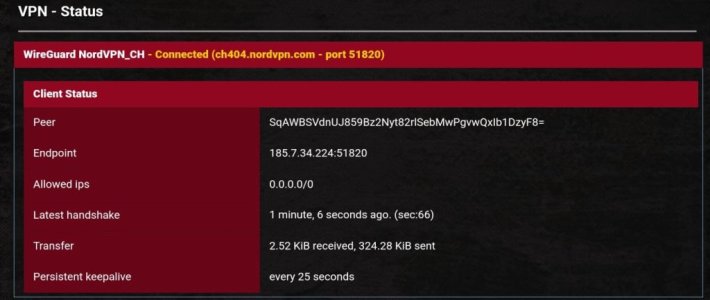

interface: wgc1
public key: sKKRdJAJLRgPd4hQj9mg/lJZc1GOJC/dEGd2lCvBEQY=
private key: (hidden)
listening port: 50446
peer: SqAWBSVdnUJ859Bz2Nyt82rlSebMwPgvwQxIb1DzyF8=
endpoint: 185.7.34.224:51820
allowed ips: 0.0.0.0/0
latest handshake: 29 seconds ago. (sec:29)
transfer: 12.07 KiB received, 730.88 KiB sent
persistent keepalive: every 25 seconds

-C:\Windows\System32>ping google.com
Ping google.com [216.58.204.238] with 32 bytes of data:
Request timed out.
Request timed out.
Request timed out.
Request timed out.
Ping Stats for 216.58.204.238:
Packets: Transmitted = 4, Received = 0,
Lost = 4 (100% loss)
-No DNS settings
-The rules are for individual IP
-PIhole was installed on Raspberry without VPN, I must say that on stock asus firmware and therefore VPN Fusion I never had problems.
I apologize for my English as a translator.
INTERFACE:
Private Key
MTU (Optional)
Address
10.6.0.2/32
PEER
Server Public Key
Allowed IPs
0.0.0.0/0
25
interface: wgc1
Ok. Well, your tunnel seems to be working. Handshake timer resets now and then and you got some data both tx and rx so it's connected.
Did you enable NAT? that is usually required on these type of vpns, here are my settings:
If "Enable NAT" is set to No, you will probably get exactly what you see now, tunnel working but no clients can connect.

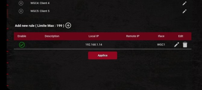

How does your routing rules look like:
ip rule
Also a picture of your vpndirector rules might help.
