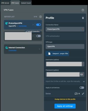

What seems to be happening is that the wifi network does redirect to the VPN fusion, but if the device isn't actually selected, its not using the VPN.
The below is a screenshot from the vpn fusion webpage. If you select Apply to all devices, it affects all wifi networks. So you appear to be forced to have to select devices for the VPN to function, even through the VPN guest network pro. Am I doing something wrong?

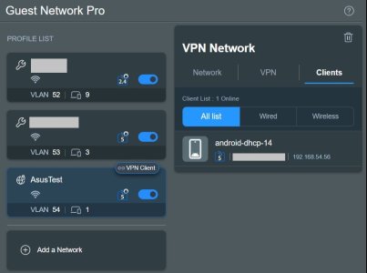

@Jherb, attached are some images of what I see on my end with a Guest Network Pro > VPN Network setup. I do not see the Guest Network VPN Network WiFi client listed on the VPN Fusion page. That client however IS listed under the Guest Network Pro VPN Network Client section as indicated in one of the attached images. The VPN Network client is running through the VPN tunnel, my other LAN/wireless clients connected to other WiFi SSID's on the router are not. The Guest Network Pro - VPN Network feature is working, as expected, for me.
For my setup I have two VPN Fusion entries (both for ProtonVPN). One of them is enabled and assigned to the Guest Network Pro VPN Network in my test.
Post edited to replace initial VPN Fusion attachment with larger image showing entire VPN Fusion page.
