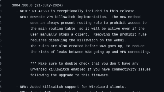

I've been having this problem also. It appears frustratingly that any VPN killswitch is active PERMANENTLY. So if you have a killswitch in any VPN settings, you will not be able to access the internet until you either activate the VPN again, or disable the setting. Which is absolutely ridiculous. So you will need to manually go in and set the killswitch in the settings each time you activate your VPN, and then manually go in and change the setting each time you disconnect. Problem only starts when you reboot your router. And find you are unable to access the internet. Even when all your VPNs are disabled. Whoever did this, is a moron.

If there is an issue (and I haven't pinned down whether there is one) it isn't the killswitch change, so let's not go down that rabbit hole.
This issue of whether the kill switch should or shouldn't be active when the OpenVPN client is disabled/OFF has been an on-going debate for a very long time, and both sides have their merits. It just depends on how YOU expect it to work for your circumstances.
I do think it has something to do with that change (Killswitch implementation) because about that time is when this problem started. I also forgot about that major change. It could be VPN-Mon maybe it's not fully compatible with the new firmware and when it restarts the vpn if it goes down maybe the routing gets blocked somehow.. IDK lol. Its just very weird.. Meaning the box actually does have internet but it cant use it, and even restarting the hardware doesn't fix the problem. it's only removing it from vpn works. Then I can put them back on the vpn and they work again for sometime. Till they randomly stop. It's also not the same ones / its random.
