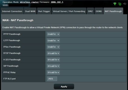

No issues with cellular Wifi calling on 3006.102.5 (RT-AX86U Pro).
Have PPTP Passthrough, L2TP Passthrough and IPSec Passthrough are enabled.
Have RTSP Passthrough, H.323 Passthrough, SIP Passthrough and PPPoE Relay disabled.
Not sure if these are the default settings but have had them this way for years.

Still no joy. I've tried most permutations of enable/disable. My mobile (cell) signal is awful where I live and wifi calling was a godsend. May need to just roll back permanently.
Here's the settings on my GT-AX6000 and I have no issues with wifi calling. As far as I can remember, these are the defaults and I've never changed them.
