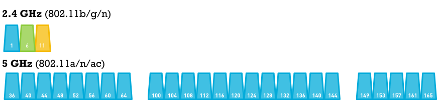

(20MHz) for 2.4GHz Band
(40/80/160MHz) for 5GHZ Band
Non overlapping channels to work with here
