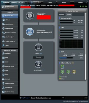

Hi.
On the topic, I have 5x XT12 connected by Cat6 lan cables.
I still get a yellow prompt in the admin console.
I use the XT12's as switches so to speak, so I have conmnected WAN port as incoming and Lan1 as outgoing on all units.
I don't really see any slowdowns, but any idea why I get a yellow notice?

It's means that this port does not seem to communicate at full speed (i.e. 2.5 G). First step is to swap the related cable with one of the other correctly working ports then if the port remains yellow then swap the devices (if possible) since if it is not cable related that it could be either the connector on the router or the one on the other device presently connected via that port.

I suspect the yellow notice may be a bug on the Network Map and not reflect reality. If you hold the mouse cursor over the yellow port 3 icon it should tell you what it thinks the link speed is.

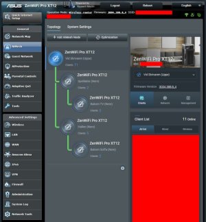

If you then go to the AiMesh page and click on the two directly connected nodes and select the "Network" tab on the right, again it should show you the uplink speed to the router.
I don't understand this. LAN1 is outgoing to what? Other nodes? You appear to have two nodes connected to LAN1 and LAN2 on the router, so what's connected to the yellow LAN3 port?
The lan3 is actually wan. I connect "in" to wan and "out" from lan.
Per your image in your first post. The WAN and LAN ports.
On the ZenWiFi Pro XT12, the bottom port (2.5/1GB LAN) port (aka LAN port #3), indicated in the yellow box below, seems to be the one you are having a problem with, yes?
