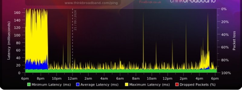

More recently I've been using two ZenWiFi XT8 nodes, again without issue, but recently I'm getting all kinds of desync in-game and I'm wondering if it was a firmware change that's tweaked settings. My ISP speeds are good, no issue on the network, I've got a broadband monitor on and it seems fine. So I'm wondering if it's the backhaul.

If you have DFS off, then your router will not be able to use the channels that can be affected by radar. If DFS is on then you can only use those channels when radar is not detected. Your router is not going to be switching backwards and forwards between DFS and non-DFS channels, so it's likely that the cause is something else!
Are there any clues in the router logs that could help further?
