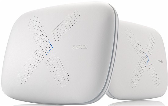

Zyxel Multy X AC3000 Tri-Band WiFi System Reviewed
thiggins
Mr. Easy
Staff member
Zyxel' Multy X AC3000 Tri-Band WiFi System is unlikely to put a dent in Orbi sales.
Read on SmallNetBuilder
