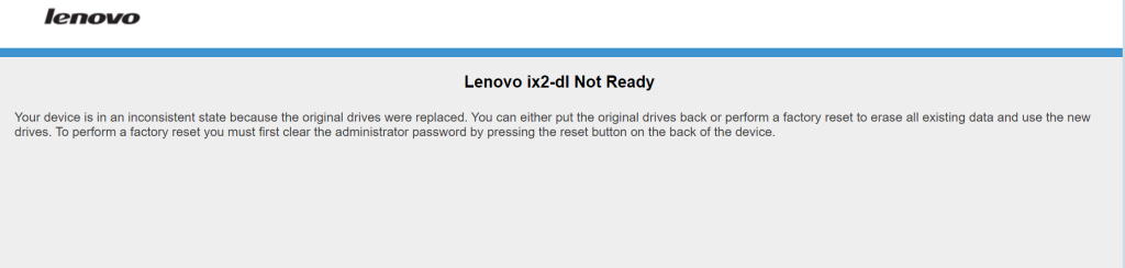

I get the following error after the power adapter failed & I replaced it. The drives were not changed. Lenovo ix2-dl Not Ready Your device is in an inconsistent state because the original drives were replaced. You can either put the original drives back or perform a factory reset to erase all existing data and use the new drives. To perform a factory reset you must first clear the administrator password by pressing the reset button on the back of the device.
How would I go about doing that? Would I have to attach the drives to my PC using an external HDD adapter? I have one.

How would I go about doing that? The web interface doesn't allow me to do anything.
Chicken and egg situation. You could just try ssh to the NAS as it might already be enabled. In this case though I would advise making a backup if you don't have one already. This is going to get dicey.
It's either not ready due to dirty disks or the ROM image is corrupt and needs a reset.
I would start with the disks if you have a couple of sata ports to plug them into and run fsck as stated before. If it doesn't find errors then the NAS needs to be reset and this is where a backup is needed since most NAS units don't let you bypass the auto format of disks. Though upon reset with the disks out it might be avoidable. Once reset you should be able to enable ssh and maybe there's an option to not initialize the disks. Once reset there might be a GUI option to import the raid vs create a new one.
