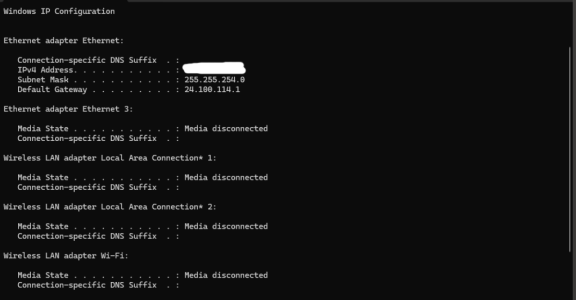

Here is what ipconfig shows for my cable modem.
I access my cable modem using 192.168.100.1.

which is the same subnet as my modem
You modem only device doesn't have LAN IP. It only has management IP - access to UI on 192.168.100.1.

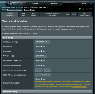

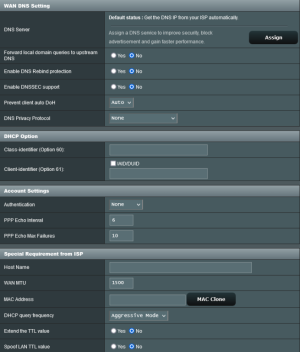

Post a screenshot of your WAN settings page on your main RT-AX68U router, perhaps something is wrong there.

I misunderstood something I read about subnets and have changed it back to 255.255.255.0. I do believe changes were needed for the media bridge because my old setup was with ATT worked. Now it doesn't.

Changing your ISP with Automatic IP doesn't require any changes on your network. You just swap the modem and if the new one is activated - you get connected. Your Media Bridge is unrelated to your WAN issues. I don't know why your Asus router shows WAN disconnected. The WAN detection is ping and/or DNS query.

Your WAN settings are correct for ISP with Automatic IP from DHCP, unless this specific ISP has some special requirements or conditions I don't know about.

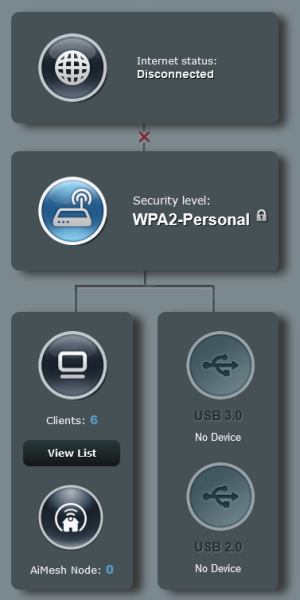

Is your main RT-AX68U router still showing WAN connection issue?
Everything seems to be working okay. Yes, status is still showing disconnected.
Yes, that is exactly how I have been setting my router's different modes for several years now. Today it does not seem to work. I have one R7000 with Fresh Tomato on it. I once used it as a bridge and will try it again.
