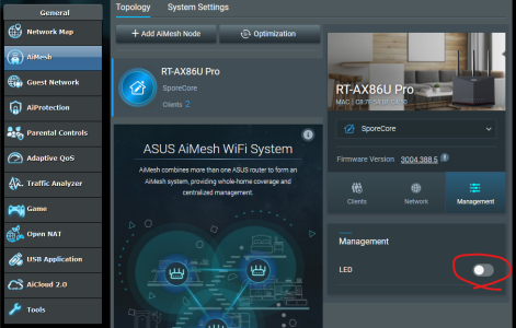

hi folks.
this is my first asuswrt-merlin router and i'm still fresh on the subjects but i'll get educated with time.
i couldn't find another reference to this issue so i'll just make a new post.
on my ax86u pro, when i reboot (or force shutdown cycle) the device, it forgets the state of the led setting.
i always have them turned off as the router is located in my sleeping chambers and the light is disturbing my sleep.
after a reboot the ui switch is grayed out but turned to the right (on) despite having been turned off before reboot.
my device currently holds asuswrt-merlin version: 3004.388.5 (i'll update this weekend)

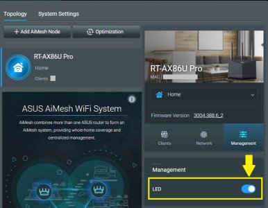

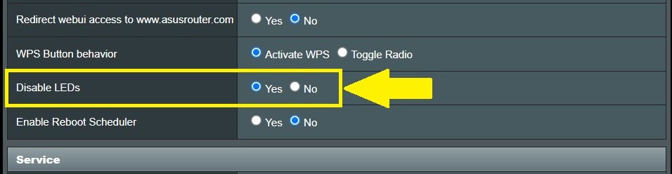

For the new folks with an RT-AX86U Pro, running Asus-Merlin firmware, there are at least four ways (outside of SSH and add-on scripts) to disable/enable the front LED's.
  • The LED On/Off button on the (facing front) right side of the unit
  • The AiMesh > Management > LED (slider)
  • The Administration > System > Basic Config > Disable LED: Yes/No
  • The Asus mobile app (Devices > router > LED ON/OFF)
So the new folks understand the issue being discussed. Some users are finding that sometimes the overly bright front LED's do not remain off upon next router reboot, or upon powering off then powering on the router. Some users are also finding that using one of the methods to change the LED On/Off setting may not be reflected in the other router GUI or Asus mobile app LED settings locations.
If one is having trouble with the LED's not remaining off when rebooting the router. Make sure the GUI Administration > System > Basic Config > Disable LED setting is set to Yes. Then test if the LED remains off after router finishes rebooting. For a single router (no AiMesh) configuration, do not use the AiMesh Management LED option to enable or disable the single router's front LED. Use instead the Administration > System > Basic Config > Disable LED option to turn off the front LED's. Using one method of enabling or disabling the front LED's may not be reflected in other options for controlling the front LED.
For SSH control of the front LED there are some examples discussed in the following thread, have not personally tried them. As always, when changing NVRAM settings you do so at your own risk.
As previously discussed up thread one can also use the LED Control script in AMTM (option: lc) to control and schedule the LED's.
