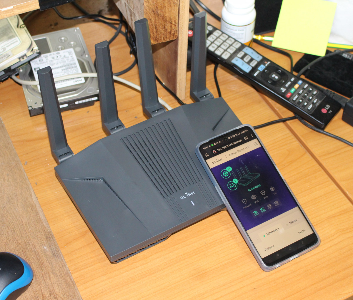

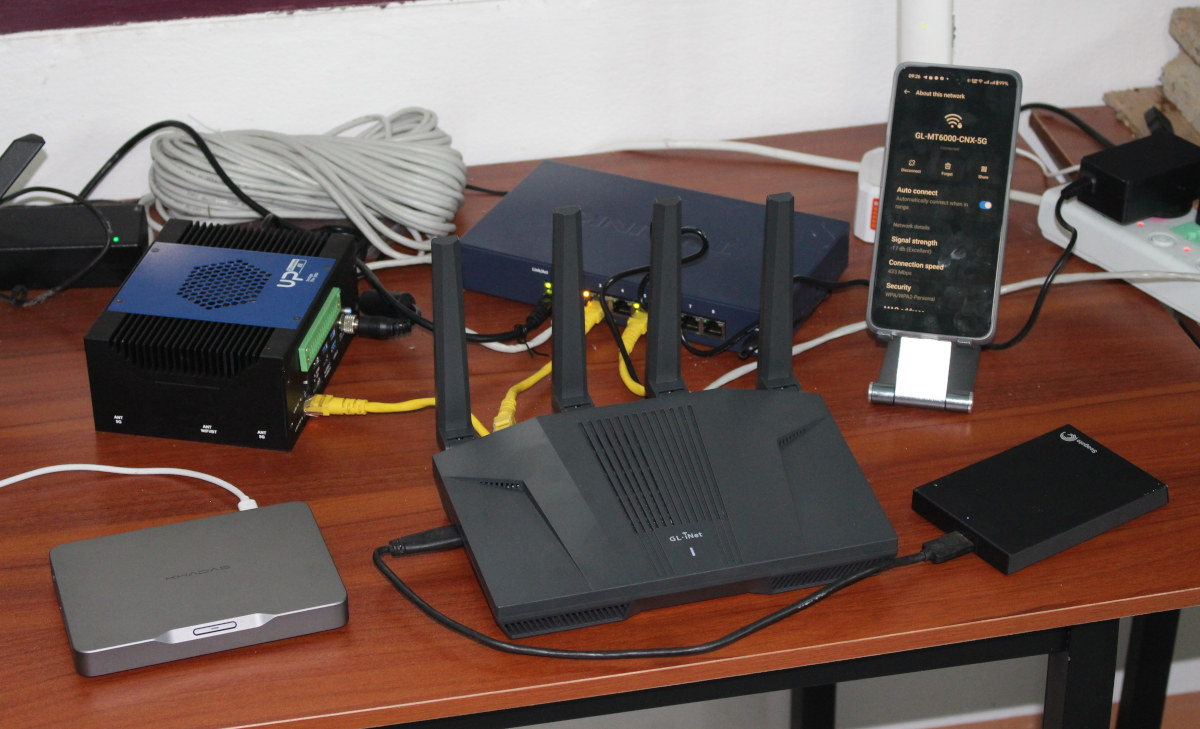

I recently got a gl.inet router as a travel router. It is a low end device - the Opal SFT1200 ($39 at Amazon). Yes it is OpenWRT which can be technically rich but challenging, but they have their own front end to it that is relatively easy and straight forward. Very easy to setup Wireguard interface to my home system and OpenVPN client for my paid VPN service. Can't really comment on it's use as my everyday driver - but definitely meets my needs for a travel router - supports WISP, small (palm size), decent range, configurable, and cheap.
I've had really good luck with their travel routers as wisp devices and the LuCl/openwrt features have been very handy- great value for functions they deliver... so far Gl.Inet has not over-promised or under-delivered...
early-on, I found three issues/bugs which they fixed very quickly (a few days) with an incremental-beta before rolling it into a release version several weeks later... very pro-reactive imo...
the flint2 came a few weeks ago but due to holidays I have yet to test it - so thanks for the link to the review which saved me time confirming the specs...
Specs look really nice and if the openwrt gets patches and improvements promptly it seem great value for the money. I read there was some 2.4 range problem possibly being fixed?
Not bad for $160 device. I like the small size too.
Good device, no doubts.
