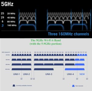

I sent mutiple emails to Asus Support USA and asked to enable UNII-4 bands in the United States, but after I got 2 replies, they stopped responding my emails. From Asus AXE-16000 feature introduction, it clearly states the 5Ghz has tree 160Mhz channels, which UNII-4 is at the last channel.
