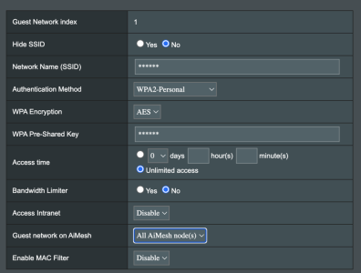

The first guest network in both 2.4GHz and 5GHz can be broadcasted to all nodes.
Since these devices use 2.4GHz, you can allocate them the first 2.4GHz guest network, and use the 5GHz guest network for your human guests.
