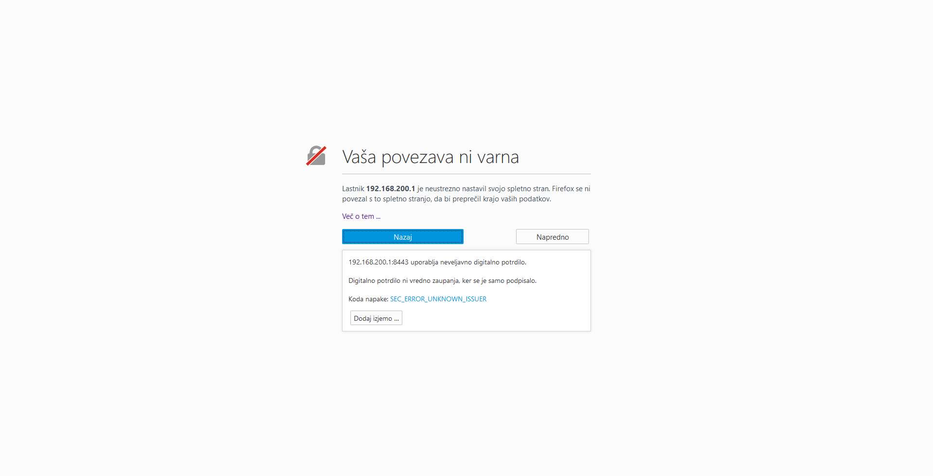

is possible to goes normaly to the router over https? i get everytime this screen and then have to go to advanced and add rule.....
Your question is about HTTPS access to router's WebUI. The problem is how to suppress browser warnings of self signed certificate used by Asuswrt's httpd.
Here are some ways to solve this for Firefox: https://support.mozilla.org/en-US/questions/1055526
Please search the forum or google next time...

i have realy big problems with my router over https with pixelserv-tls.....kaspersky and firefox browser everytime stop me to get in.....i know that is not problem with pixelserv but with http protocol i do not have any problems.....
Can you describe the bold in a bit more detail what problem are you exactly facing?
LOL @bayern1975 I had no clue at the first glimpse of your screenshot.
You're lucky. Here might be a workaround for your Kaspersky issue. I wish Kaspersky would have offered users a 'whitelist' facility to allow good-known self-signed certs. But the below seems the best they could offer you:
http://i.stack.imgur.com/TxItR.png
http://support.kaspersky.com/us/12489#block1
Worth a try...
EDIT:
Actually forget the above.... worth trying adding the HTTPD self-signed cert into Windows just like how you did for ca.crt. I bet security applications such as Kaspersky honour all certs in system-wide Windows vault.
