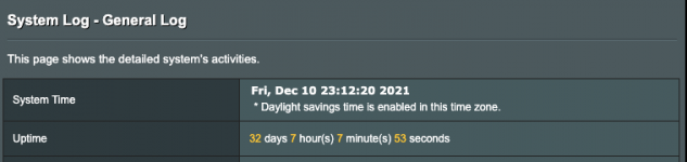

Yup. Still waiting for fixes. Earlier in the thread the version this problem started with was isolated and relates to newer/unstable Broadcom drivers (binaries that are not part of the open source project). I went back to 384.19 since 386 is not stable at this point and no new binaries have been integrated or workarounds attempted in 386. I went for 32 days on 384.19 until I had a weird issue that required a reboot. Once a meaningful attempt at a fix/update is made, I will give 386 a try again.
