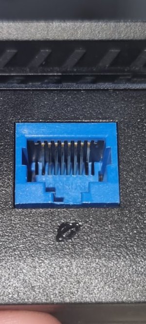

Visually inspect the ethernet sockets on the router and the ONT. Look for dirty, corroded or bent contacts.
Not bent that I can't tell. Not sure if the far end ones are supposed to be higher up than the middle ones, though?

I've uploaded a photo of the WAN port on the back of the router, above. Could the issue be with the two pins on either end? They appear not to be fully extended?
Yes that does look odd. The pin on the right of your picture in particular looks like it's pressed in too much. Compare that socket to the other LAN sockets. What do they look like?

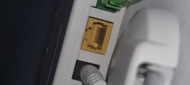

I've taken a picture of the ONT and you can clearly see all pins are fully extended.
The same for the pins in the LAN ports.
Given that the router is right out the box, this seems to be a manufacturing fault.

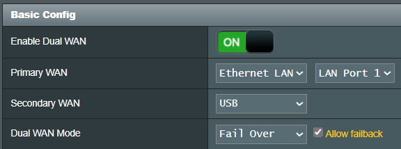

I've had success in the past using a small pair of tweezers to pull those bent pins back into position. Try that.
If that doesn't work you can try reassigning one of the working LAN ports as a WAN port. Do that in the WAN - Dual WAN settings.
I couldn't fix it with tweezers but your suggestion of Dual WAN worked perfectly!
