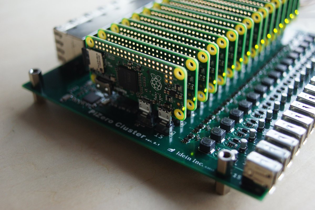

A few years ago I experimented with compiling from a ram disk. It wasn't any faster than from my SSD, so my bottleneck remained my CPU.
Maybe a cluster of this could help.. :)
