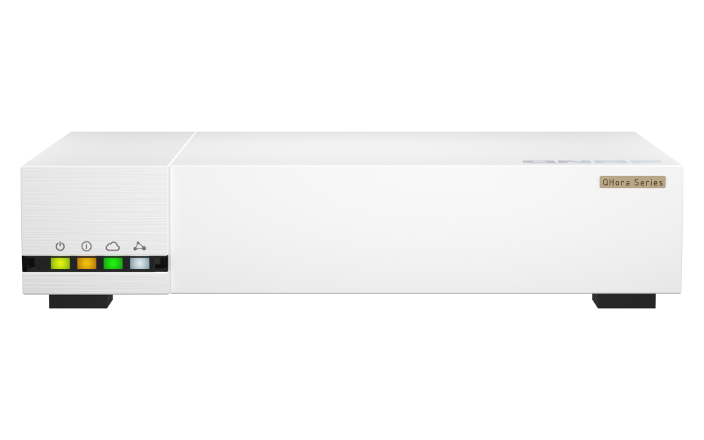

How about this? It has three 10 Gbps ports and six 2.5 Gbps ports.
Someone else in the forums got one. It also fits your budget.

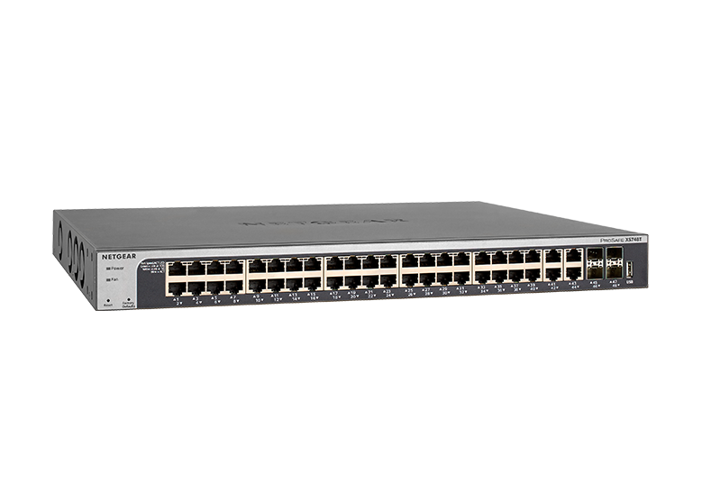

Not sure if you're gonna hate me or not...
Someone offered me up a Netgear XS748T switch for free - decom as part an upgrade...
don't hate you but a bit jealous :)
I had 2 Netgear switches and they both were excellent. I will be looking at buying one once it makes sense from an ISP point of view. My pfSense box is ready for it and i have a spare X550-T2 ready to install in my TrueNAS box but as long as i am only on 1Gb internet, i don't really see the point of converting the entire network. Also, i would need POE+ for my AP's which i haven't found on a 24 port 10Gb switch so far. Maybe i haven't been looking at it enough though....not sure.

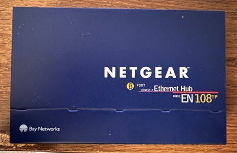

I've kept the EN108 as it's nice for debugging network issues - because hub vs switch - a managed switch can do port mirroring, but hubs make it really easy..
It's a lot like the old-school Netgear FA310 PCI cards - choice back then for Linux, as they were fully supported with the 2.x kernels back in the day...
