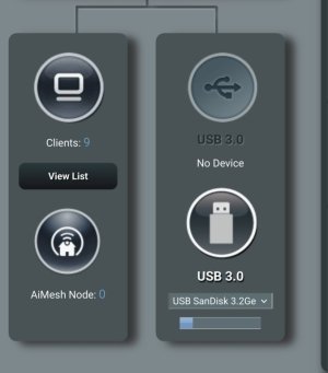

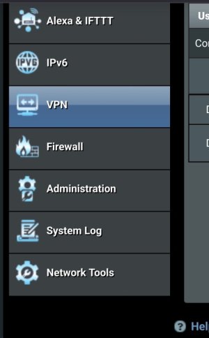

Hi good people.
I habe a AX88U with Firmware 3004.388.7. I have installed skynet, spdmerlin and another for measuring pings but forgot the name.
I did few days ago update of amtm and skynet and the tab Addons was here. Today I moved the router and in the process restarted it. Went to check my spdmerlin and it's not there. I can see the usb.
Any help would be appreciated.

1. Done, no change.
2. Follow up questions: Do you have the disk check script installed in amtm? No
Did you perform a upgrade to your router recently? No.
Did you unmount the drive before upgrading your firmware. No.
Did you have any recent power failures that may have suddenly turned off your router. No, but my wife plugged the power cable out.
Are you using a USB Stick or external SSD? usb
Does the dcl log show corruption to the drive that might have been corrected; if yes post log below. Dont know how to do that? Please advise.
4.Have you experienced any similar issues with addon's not showing or asking to be reinstalled in ssh? No.
5.Does this still happen when you remount your drive and reboot. Yes.
6.Did you at any point use the built in Asus health scanner. (potentially not compatible with entware as it may use optware which is depreceated and optware isn't compatible with entware.) No.
But, tried to run spdmerling from amtm and got error that entware was not installed. Installed it, it prompted that it can use the old installation and it did, restarted and everything is now here. Thank you for the quick support guys! It seems that entware files got somehow corrupted and not I have addons tab back.
