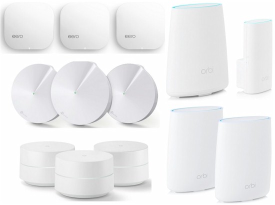

Wi-Fi System Roundup

Tim great work on the thorough testing but I think allowing the systems to utilize 40 MHz on the 2.4 ghz band might make the results unrealistic in real world usage.
I know you touched on it in the review and we see it quite clearly in the graphs for 2.4 especially compared to google WiFi but doesn’t it impact the other test results as well? These Eero and tplink systems look like they’re using 2.4ghz at 40mhz for the back haul and google WiFi isn’t. This puts google at a disadvantage which may not be true in real world usage where 40mhz can’t be used.

Depends on how much a product is using 2.4 GHz for backhaul. But yes, 40 MHz bandwidth would be used for backhaul, too, which should result in higher numbers.
