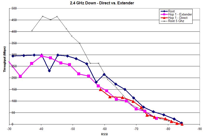

Trying to decide between a router and a Wi-Fi System? This experiment should help you choose wisely.
Read on SmallNetBuilder
Most Wi-Fi Systems have apps that guide node placement. But they do not expose the criteria used for guidance.
